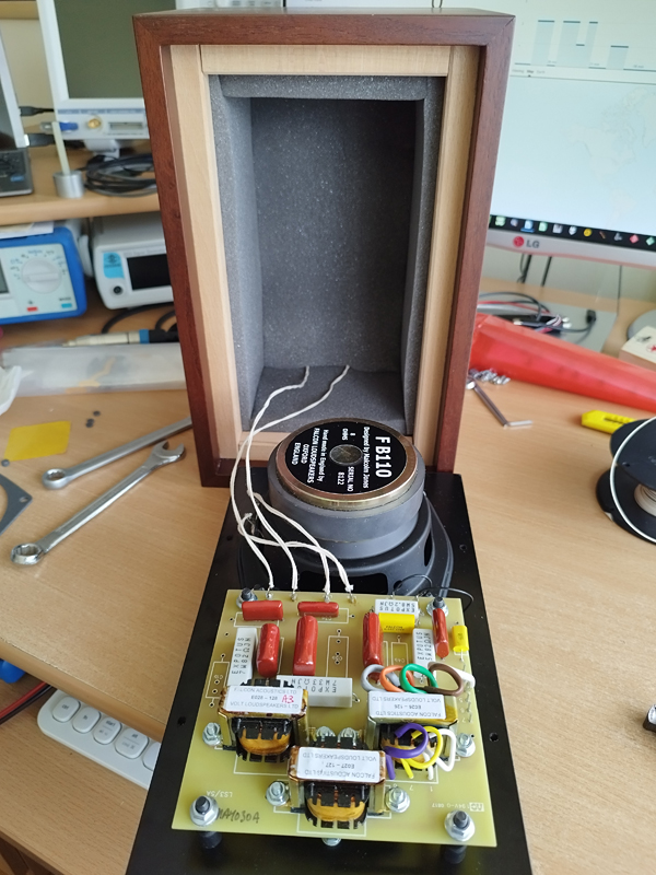

And, as I recently had no time to deal with my designs, cutting a story on deciding short, I settled on making a pair of LS3/5a BBC monitors. The good thing is, Falcon now offers the complete and very nice kit. And I already had their "silver badge" crossovers, which is why you will see this version here. Late Falcon's "gold badge" improves on the inductors and uses the capacitors claimed to "simulate" the polycarbonate type, which was used originally by BBC. I agree that now obsolete polycarbonate caps were more pleasant sounding than polypropylene (nowadays ubiquitous "high-end" parts, that I personally never liked very much), so once I will tweak these parts for sure. But for a start, I just left these silver badge crossover boards as they are.

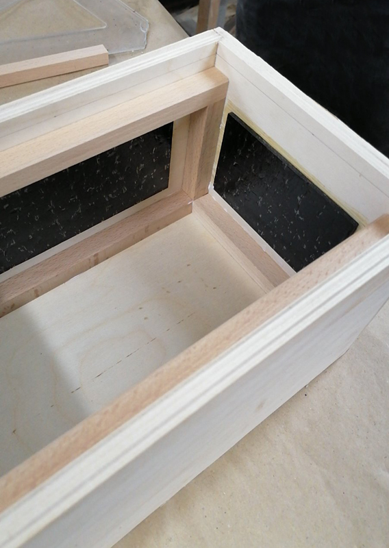

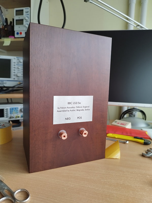

So, I also settled on using the walls, the front baffle, and the damping as specified by BBC and supplied by Falcon. Dragan Pantelić and his son Oggy did all the necessary woodwork nicely, putting the cabinets together and making them look nice and cute, and then I put everything inside in one afternoon. And the pictures below show the result. You will also notice Audial binding posts and Jupiter hook-up wires.

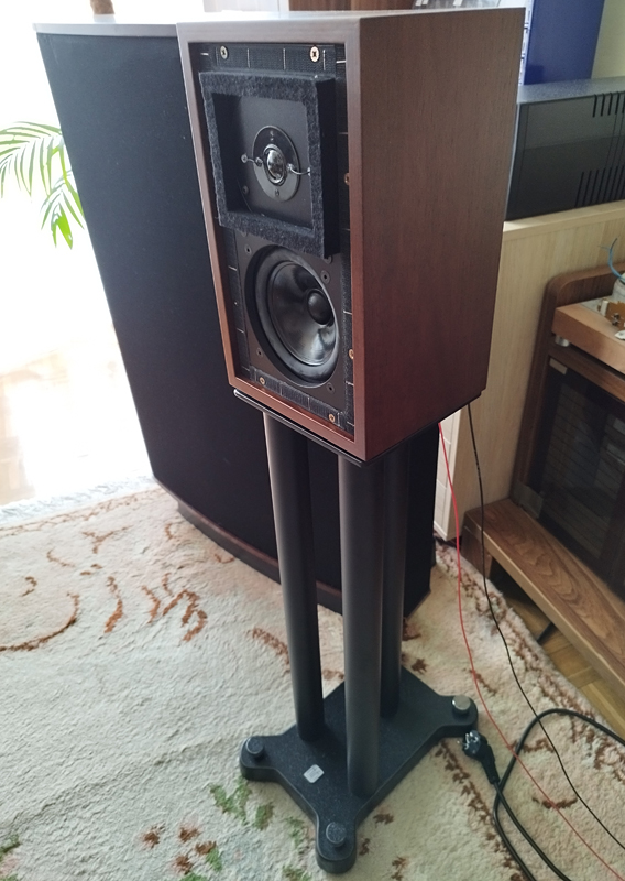

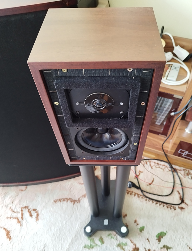

Quote from Pedja on 20 August 2023, 8:06 PMYou will not see the tweeter metal grills here, although I did buy them, however only to prove to myself that they must be omitted. Such additions are often necessary protection for the tweeters cones in the unknown, and especially in "professional" environments where these speakers can be used, and you will often find the claims about them linearizing the falling frequency response in the upper end (and you will find this also in the original BBC LS3/5a article - https://downloads.bbc.co.uk/rd/pubs/reports/1976-29.pdf - please see page 2, that is PDF file page 7). While nominally true, such a "linearizing" comes only with parasitic artifacts, which is something I want to avoid whenever possible. So I tried these speakers both with and without these grills, and I will not put them back anymore. Damping felt squares around the tweeters is on the other hand a very good idea, and they will also provide (indirectly) some kind of mechanical protection for the domes.
