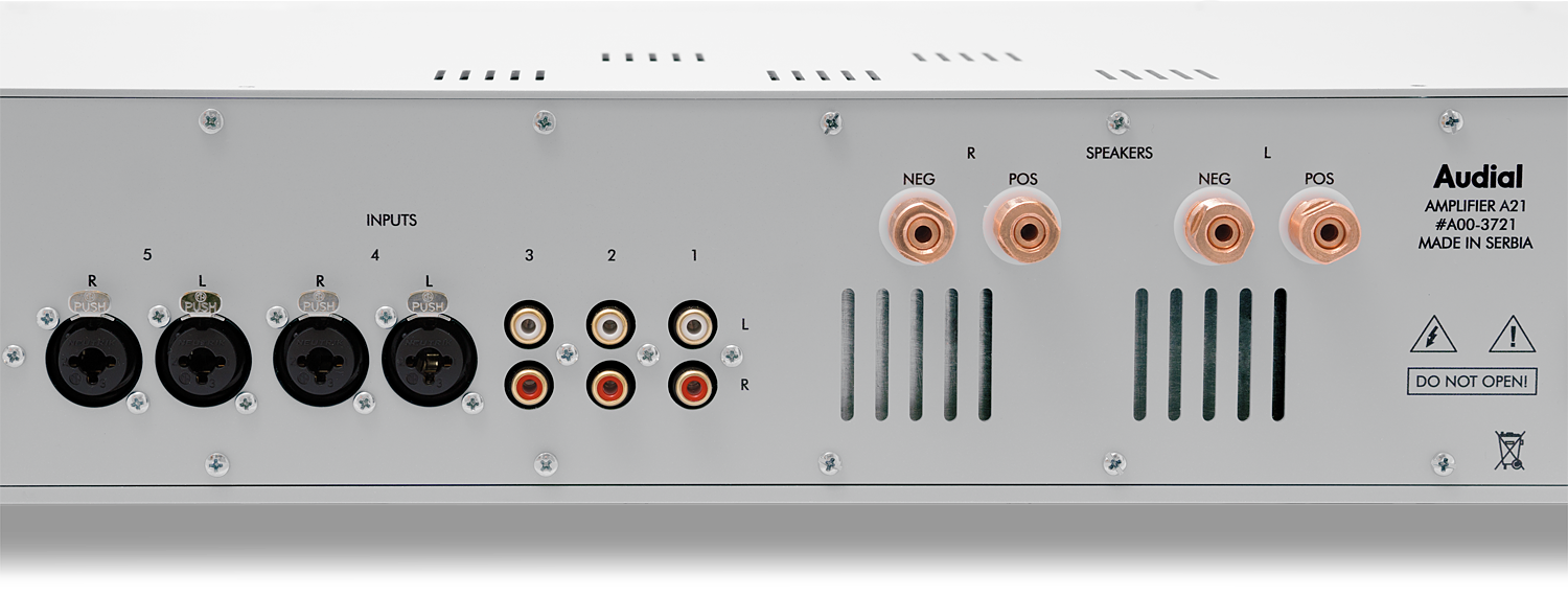

The A21 employs three unbalanced RCA and two balanced XLR inputs. These two later inputs can also be used as unbalanced inputs, due to Neutrik XLR “Combo” connectors, which can also accept the phone jacks (the jacks are wired to accept both balanced and unbalanced signals).
Just like the A20, the A21 will also include a JFET buffered pre-out (RCA only), and Audial-made pure copper binding posts.
